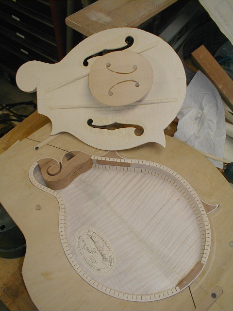

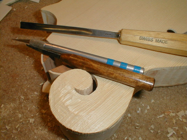

Not too many members here build mandolins, but I have built a few F's and A's. On the F's I leave the scroll "unopened" until the plates are glued to the rim. I use a jigsaw blade with a wooden handle on it to open the "strap holder" area, then clean things up with a small knfe and a Dremel.
Sure you can use the top with the ruined scroll for an A model as long as you didin't cut into the A body outline. The archings and shape minus the scrolls and points make and excellent A.
Here are a couple of pictures of a Dudenbostel mandolin before and after the scroll is opened (the funny thing attached to the underside the top is a "Virzi Tone Producer", one of the things that Lloyd Loar experimented with on the early twenties Gibson F5's)
Before:
After (you see the tools Dude uses for the operation in the picture, this was the inspiration for my jigsaw blade tool):

Hey Arnt, I noticed that the Virzi is closer to the bass brace than the treble.
is there a reason for positioning it that way?
are you looking to add mass to the bass side?
I have made two F style mando`s but hav`nt had a chance to hear what difference the virzi makes in one.
Matt

Matt, I have never played a mandolin with a Virzi, let alone built one so I don't know much about them or exactly where you want to place them. Many, if not most of the original Loars that had them installed originally have had them taken out. Loar experimented with Virzis in all of Gibson's Master Model mandolins, mandolas, and guitars, as well as violins and violas. Today some builders are makeing instruments with them, especially ones who specialize in Loar reproductions.
From what I have read a Virzi tends to make the instrument a bit quieter, which is to be expected with the added mass to the top, but since it is coupled to the top by two sometimes three "feet" in the middle of the disk, its rims are toatally free to vibrate, as opposed to the soundboard which is fixed to the sides along it's perimeter, and thus emits an entirely different series of overtones or "partials". Or so the theory goes.
I believe the mandolin in the picture was built for Chris Thile, so you can probably hear it in some of Nickle Creeks records!
